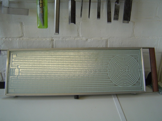

[QUOTE=L. Presnall] Okay, now once a guy has his glue right how the heck does he go fast enough to use it? I'm thinking of laying my bridge on my heating blanket to get it hot, then racing it to it's spot on the guitar!!!?? [/QUOTE]
As Russell said, I always have my braces and bridges sitting on an electric food warmer, and then use a hair dryer on the top to bring that up to temperature to give more working time with the HHG. I bought it cheap on eBay. The good thing about this is that it is thermostatic so you can get the braces up to temp and keep them there until youneed them.
With my food warmer tray, baby bottle warmer and hairdryer I'm thinking of writing a book on "Household appliances and the art of luthiery"!
